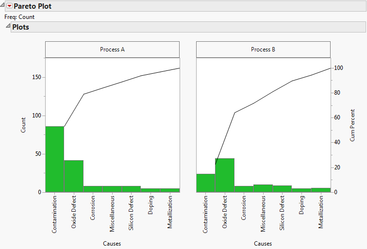

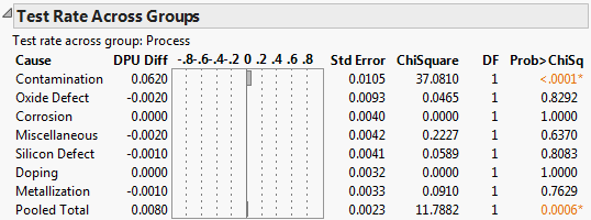

This example uses the Failures.jmp sample data table, which contains failure data and a frequency column. It lists causes of failure during the fabrication of integrated circuits and the number of times each type of defect occurred for two processes. A constant sample size of 1000 is specified for this example.
