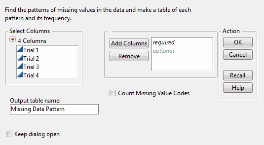

With your data table open, select Tables > Missing Data Pattern.
Click Add Columns.
Select the Count Missing Value Codes check box if you want to count missing value codes as missing values.
5.
Click OK.
Select Tables > Missing Data Pattern.
Note: For details about the options in the red triangle menu, see Column Filter Menu in Get Started.
Click Add Columns.
5.
Click OK.

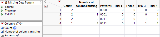

A Missing Data Pattern Table shows the following patterns:
Row 1 shows that there are two instances where all rows in Trial 1, Trial 2, Trial 3, and Trial 4 have no missing values.
Row 3 shows that there are two rows in the source table whose missing values are in the Trial 3 and Trial 4 columns.
Row 4 shows that there is one row in the source table whose three missing values are in the Trial 2, Trial 3, and Trial 4 columns.
The Count column is assigned the frequency role. If you now use the Missing Data Pattern data table to run an analysis, JMP automatically uses Count as a frequency. For details, see Assign a Preselected Analysis Role in The Column Info Window.
