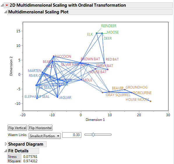

There is a list from which you can choose to show the Smallest Portion or the Largest Portion of links on the plot. The portion of links shown is controlled by entering a value in the box or by using the slider. MDS Plot with Waern Links shows Waern links for the Teeth.jmp data table for the 33% smallest portion.
