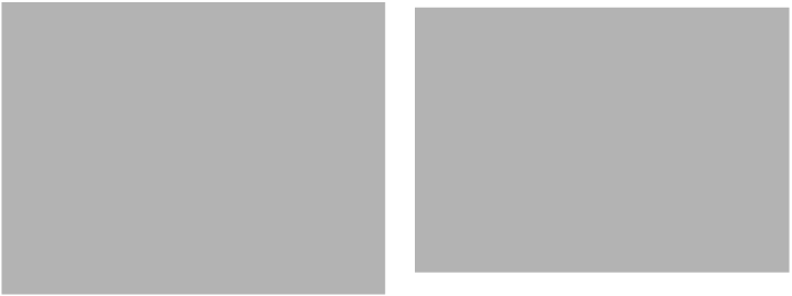

As you run a script, the output appears in the log window. The actual script is shaded in the log, and the output appears beneath it (The Script Window (left) and the Log Window (right)).

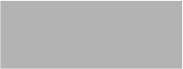

Syntax and compatibility errors are reported in the log, including the line number and code that JMP could not process (Syntax Error Message).
