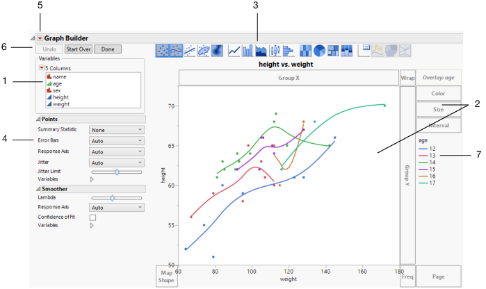

To launch Graph Builder, open your data table and then select Graph > Graph Builder. The Variables list contains the columns in your data table, which you can drag into zones.
Figure 2.2 Graph Builder Window for Big Class.jmp
Tip: For descriptions of the column options in the Variables red triangle menu, see Columns Panel in the Using JMP book.
To re-create and modify the graph in Figure 2.2, follow these steps:

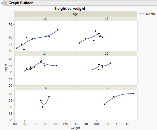

The graph in Figure 2.2 appears. The relationship between height and weight for each value of age is shown using color in a single graph.
6.
Figure 2.3 Height and Weight Grouped by Age
