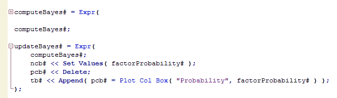

After you select this preference, Function and Expr expressions are foldable. See Add More Folding Keywords for details about adding folding markers to other expressions.
Figure 3.7 Code Folding Markers Shown in a Script
