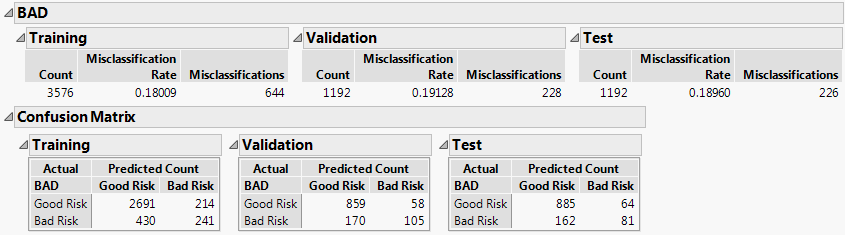

Select Help > Sample Data Library and open Equity.jmp.
Select Analyze > Predictive Modeling > Naive Bayes.
Select BAD and click Y, Response.
One of the potential predictors, DEBTINC, has many missing values that might be informative. However, naive Bayes is not prepared to handle large number of missing values well, so you do not include DEBTINC in your model.
Select LOAN through CLNO and click X, Factor.
5.
Select Validation and click Validation.
6.
Figure 8.8 Naive Bayes Report for BAD
The Naive Predicted Formula Bad column contains a formula that assigns an observation to the class for which the observation has the highest naive probability.
