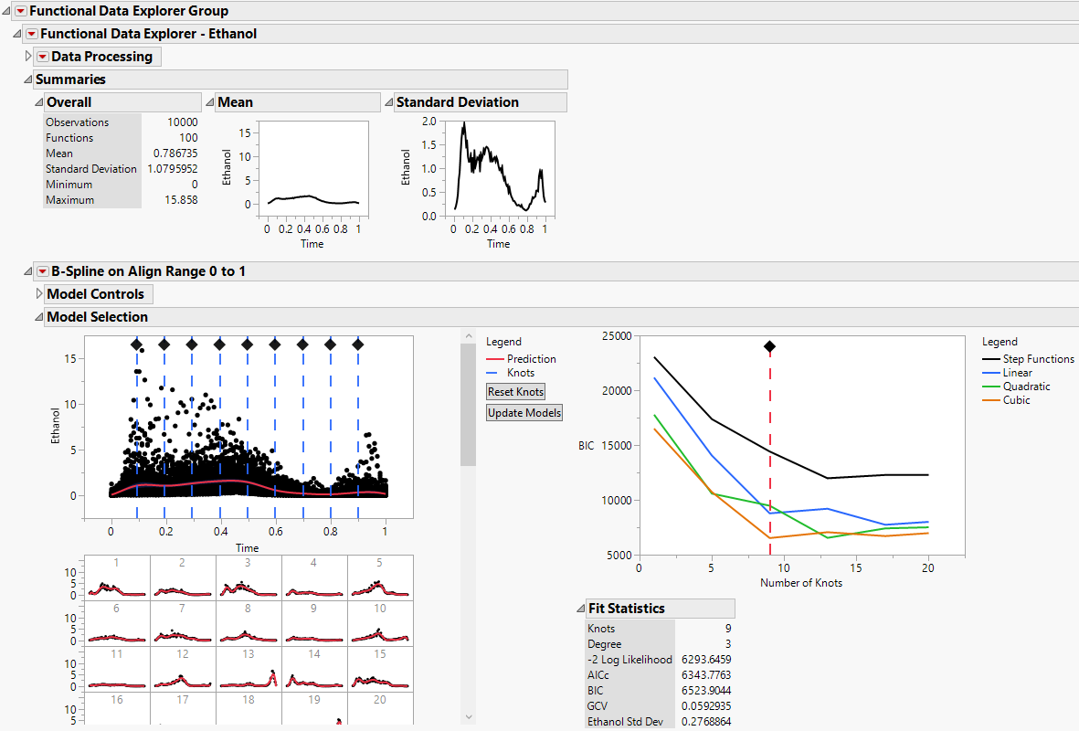

Click the Functional Data Explorer Group red triangle and select Models > B-Splines. This fits a B-spline model to each of the functional processes.
Figure 13.7 Functional Data Explorer Report for Ethanol
Figure 13.8 Model Summary Report for Ethanol
Figure 13.7 and Figure 13.8 show the model reports for one of the functional process variables, Ethanol. Scroll through the full report to view the models fit for each of the process variables. Next, use the FPCs in the Function Summaries report in an analysis.

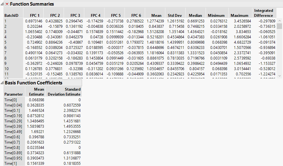

Press Ctrl, click any Function Summaries red triangle, and select Customize Function Summaries.
In the box next to Enter number of FPCs to show, type 3.
Click the Deselect All Summaries box.
Click OK.
5.
Click the Functional Data Explorer Group red triangle and select Save Summaries.
6.
7.

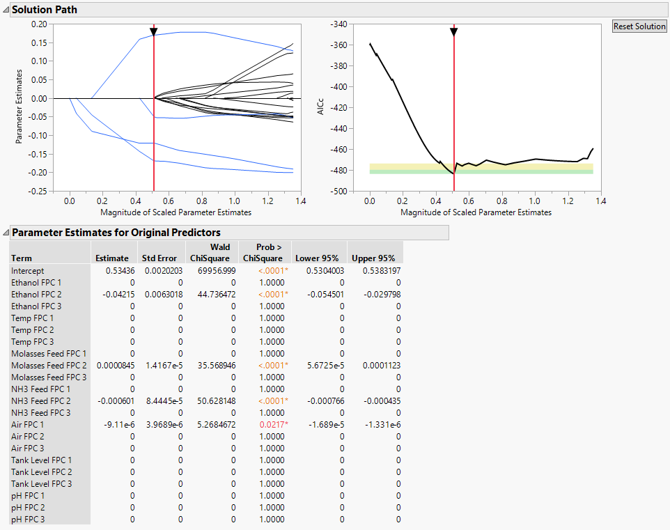

Use the Generalized Regression personality of the Fit Model platform to determine how Yield is affected by the functional process variables.
6.
Click Run.
7.
Click Go.
Figure 13.9 Generalized Regression Report for Batch Yield
