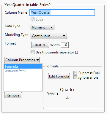

Select Cols > New Columns. In the Column Name box, type Year.Quarter.
Select Column Properties > Formula.
Select Year and then click the plus sign.
5.
Select Quarter and then click the division sign. Type in 4 and press Enter.
6.
Figure 15.16 New Column

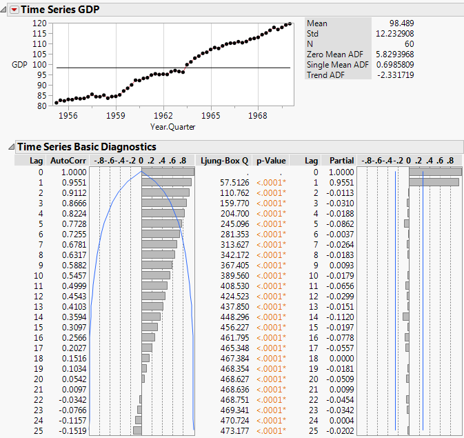

Figure 15.17 Time Series Report for SeriesP.jmp

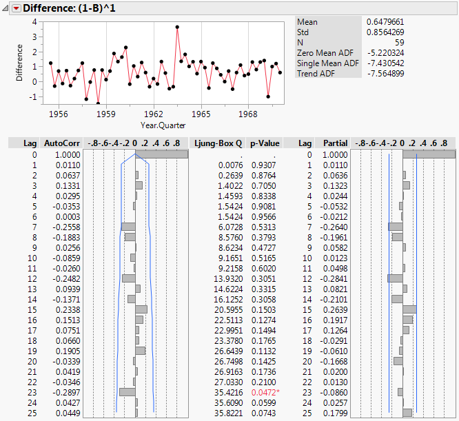

Figure 15.18 Difference Report for SeriesP.jmp

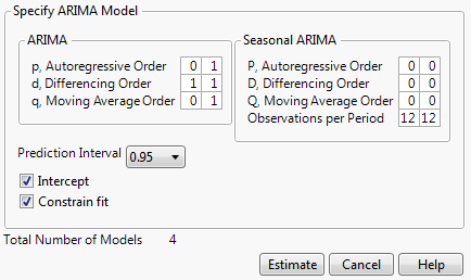

Click the Time Series GDP red triangle and select ARIMA Model Group. This enables you to fit multiple ARIMA models for a range of values of (p,d,q)(P,D,Q).
Fix d, the differencing order, at 1 by setting the range from 1 to 1 because the differencing report showed lag-1 differencing was appropriate.
Set p, the autoregressive order, to range from 0 to 1 because the original series showed evidence of autocorrelation.
Set q, the moving average order, to range from 0 to 1.
Leave P, D, and Q set at 0, since the series showed no evidence of seasonality.
Figure 15.19 ARIMA Model Group Specification
11.
Click Estimate.

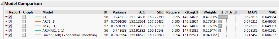

Figure 15.20 Model Comparison Table

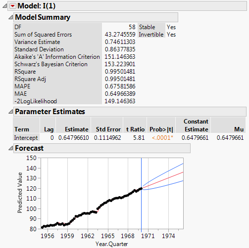

Figure 15.21 Model Report for ARIMA(0,1,0)
