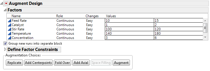

Select DOE > Augment Design.
5.
Click OK.
Figure 5.12 Choose an Augmentation Type
6.
Select Group new runs into separate block to add a blocking variable to the design.
7.
Figure 5.13 Reactor Data Design Augmented with a Replicate

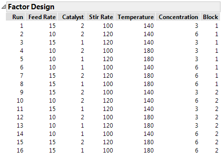

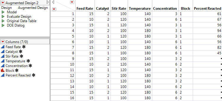

Click Make Table.
Figure 5.14 The Replicated Design
