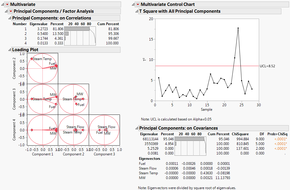

Figure 15.12 Multivariate Application

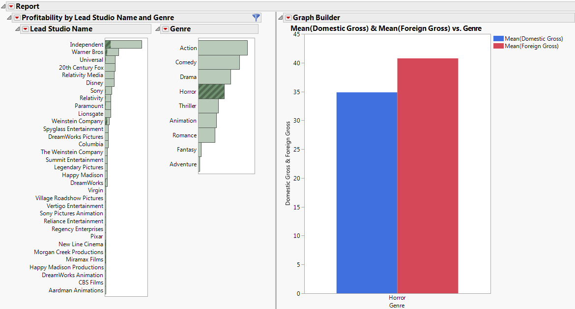

Right-click the primary report and select Use as Selection Filter.
Select Run Application from the Application Builder red triangle menu.
Figure 15.13 Example of Filtered Content

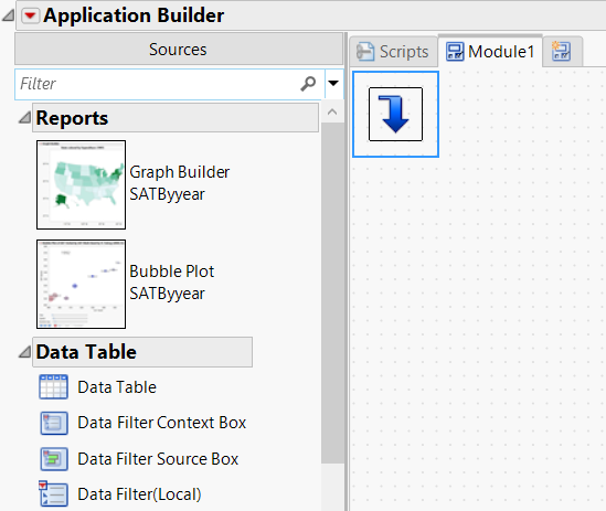

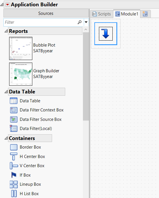

Double-click Data Filter Context Box.
Figure 15.14 Adding a Data Filter Context Box

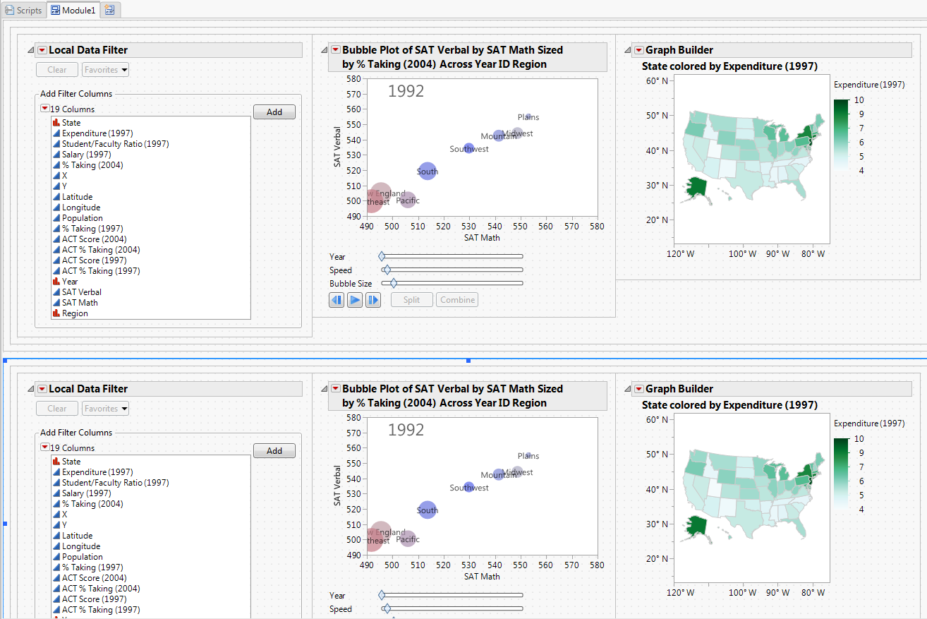

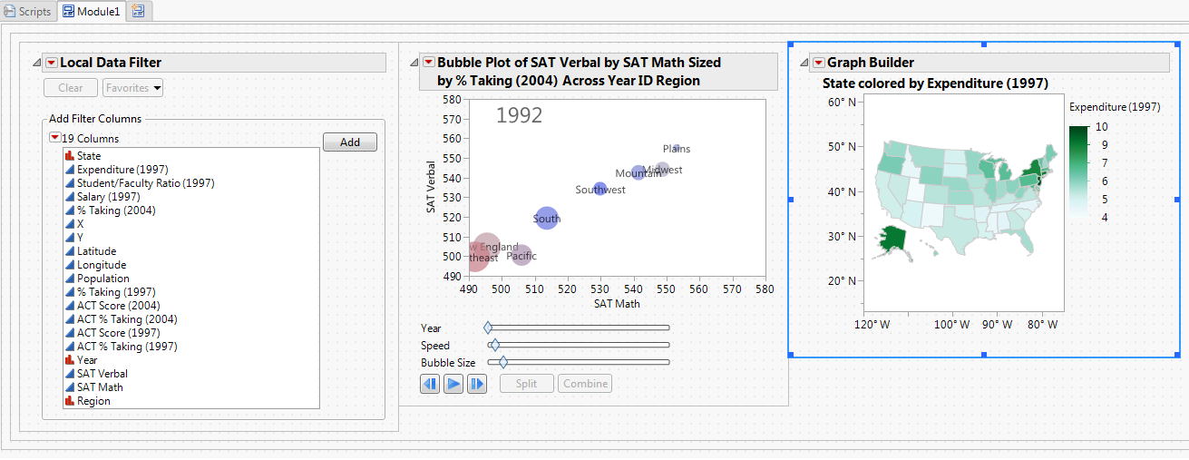

Figure 15.16 Adding Local Data Filter and Two Reports

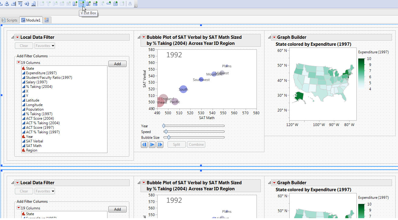

Figure 15.17 Copying Local Data Filter and Reports
10.
Click the Application Builder red triangle and select Run Application.
11.
In the Local Data Filter at top, click SAT Math, then click Add. Move the slider to see how it only impacts the reports at top. Do the same for the bottom set of reports.

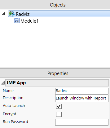

Click the Scripts tab and select Radviz from the Namespace list.

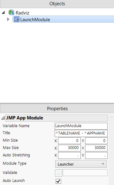

In the Objects pane, select Module1.
Figure 15.21 Customizing the LaunchModule

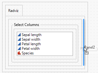

Figure 15.23 Adding the Panel Box
Figure 15.24 Adding the Col List Box

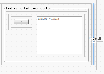

Figure 15.25 Adding a Panel Box
Figure 15.26 Adding a Cancel Button

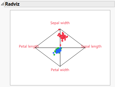

Figure 15.27 Iris.jmp Graph

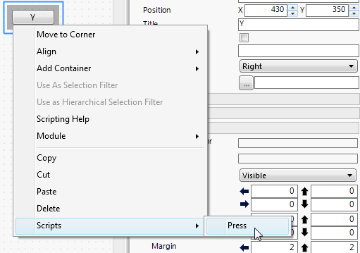

Figure 15.28 Adding a Script Interactively
Selecting a script from the Scripts menu adds a placeholder script to the Scripts tab for the selected module. For example, the Press script shown in Figure 15.28 adds the following script to the Scripts tab:
Button5Press=Function({this},
// This function is called when the button is pressed
name = this << Get Button Name;
Fill in the placeholder script with your own JSL. In the application that you previously created, you named two variables SetY and ColumnList. Rewrite the preceding placeholder script as follows:
