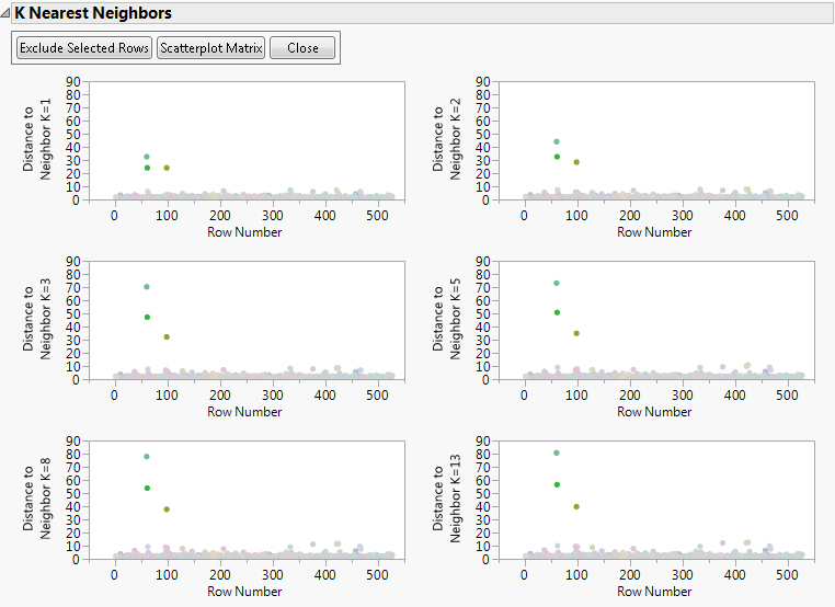

Notice the three extreme outliers selected in the K Nearest Neighbors plots in Figure 2.9. Each of these three rows corresponds to a date when the secondary settler in the water treatment plant was reported as malfunctioning. Because these three data points are due to faulty equipment, exclude them from future analyses.
8.
Select the three extreme outliers and click Exclude Selected Rows.

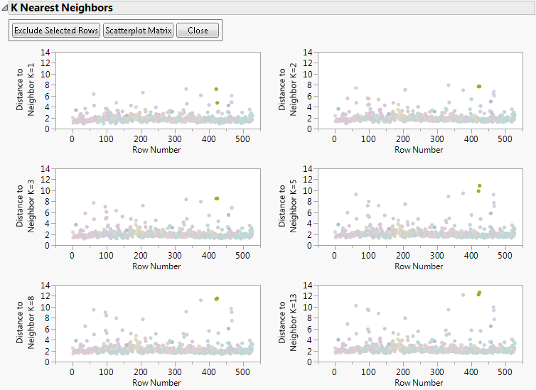

Click OK.
