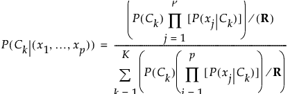

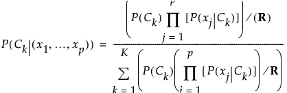

Denote the possible classifications by C1, …, CK. Denote the features, or predictors, by X1, X2, …, Xp.
The conditional probability that an observation with predictor values x1, x2, …, xp belongs in the class Ck is computed as follows:
where R is a regularization constant. In the formula above, the conditional probability that an observation with Xj =  xj belongs to the class Ck, P(xj|Ck), is given as follows:
