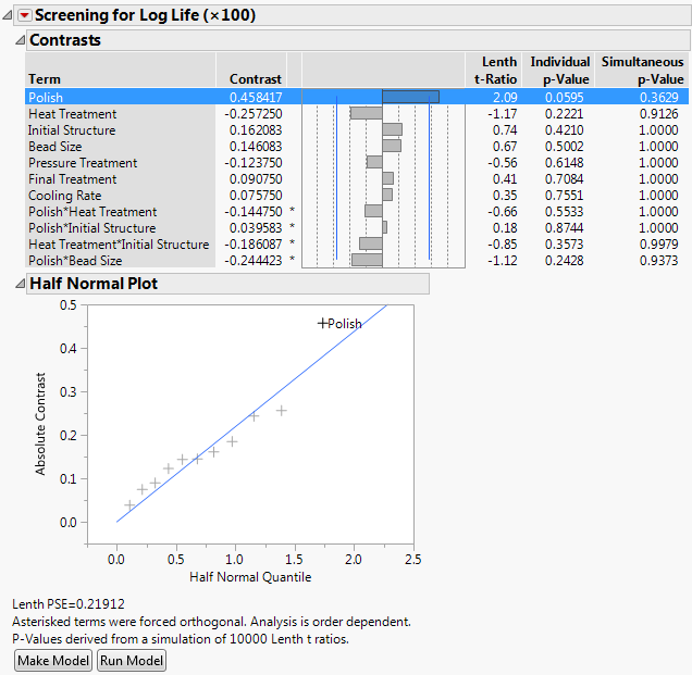

Select Analyze > Specialized Modeling > Specialized DOE Models > Fit Two Level Screening.
The seven factors Initial Structure, Bead Size, Pressure Treatment, Heat Treatment, Cooling Rate, Polish, and Final Treatment are specified for X.
The only significant effect identified is Polish. Note that asterisks mark four terms, indicating that they are not orthogonal to the effects preceding them. The contrast values obtained for these effects are after orthogonalization. As a result, these estimates do not match estimates obtained from a corresponding regression analysis. You can use the Run Model button to fit the single-factor model.
