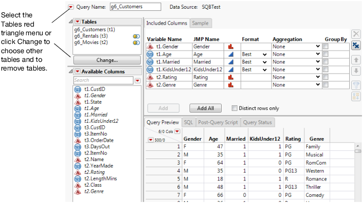

Select File > New > Database Query, connect to the database, and select the SQBTest schema. (See Connect to a Database for details.)
Click Build Query to show the Query Builder window.
5.
In the Available Columns box, select t1.Gender, t1.Age, t1.Married, t1.KidsUnder12, t2.Rating, and t2.Genre.
6.
Click Add on the Included Columns tab.
Figure 2.33 Selected Columns
7.
Select the SQL tab below the columns to view the SQL statements for your query. This code is saved as a data table property after you run the query.
8.
Click Save in the lower right corner.
Your work is saved as g6_Customers.jmpquery, which you can open later to return to this point or to run the query.

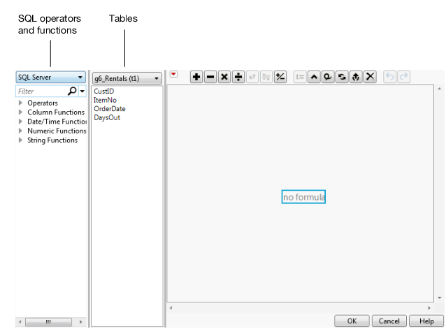

From the Available Columns red triangle menu, select Add Computed Column.
The Computed Column window appears (Figure 2.34). The window contains the JMP Formula Editor.
Figure 2.34 Computed Column Window with Formula Editor
Operators and functions are provided in the list on the left side of the Formula Editor (Figure 2.34). In some instances, you might need to change the server type based on your database.
The Operators list does not provide a Concatenate (||) operator. You must type the formula in the Formula Editor box.

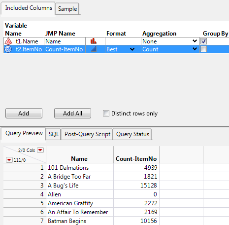

The Group By check box is selected for t1.Name (Figure 2.38). All instances of a specific movie name will be grouped into one row.
Figure 2.38 Grouped Columns
6.
Click Run Query to import the data.
7.
Figure 2.39 Sorted Count-ItemNo Column

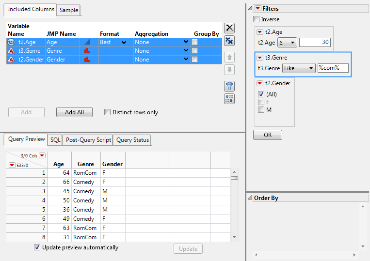

Set the t2.Age filter to ≥ 30.
8.
The % wildcards match any number of characters before and after “com”. On the Query Preview tab, notice that movies in both the RomCom and Comedy genres are shown (Figure 2.40).
Figure 2.40 Selecting Filters

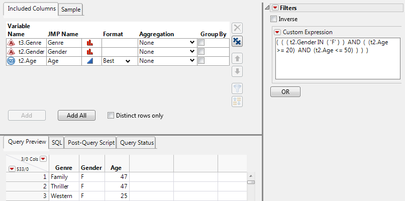

From the Filters red triangle menu, select Add Custom Expression.
( ( ( t2.Gender IN ( 'F' ) ) AND ( (t2.Age >= 20) AND (t2.Age <= 50) ) ) )
Figure 2.41 Writing a Custom Filter Expression

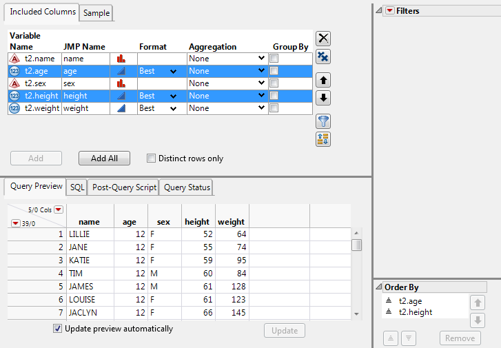

Figure 2.42 Selecting the Order By Columns
6.

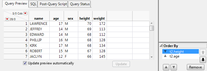

In the Order By outline, select t1.height and then click Sort the values in descending order
The height column is sorted from tallest to shortest.
7.
The height column is sorted first. Values in the age column are sorted within each level of height. For a height of 68, age is sorted from 14 to 17.
Figure 2.43 Result of Reordering Columns
