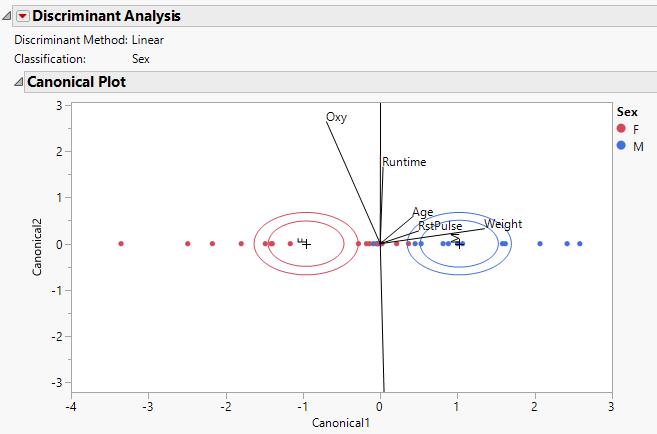

Figure 4.10 shows a Canonical Plot for the sample data table Fitness.jmp. The seven continuous variates are used to classify an individual into the categories M (male) or F (female). Since the classification variable has only two categories, there is only one canonical variable.
Figure 4.10 Canonical Plot for Fitness.jmp
The points in Figure 4.10 have been colored by Sex. Note that the two groups are well separated by their values on Canonical1.
Weight, RstPulse, and Age are positively associated with Canonical1. Weight has the highest degree of association. The covariates RstPulse and Age have a similar, but smaller, degree of association.
Oxy is negatively associated with Canonical1.
