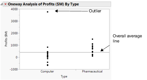

Figure 3.92 Profits by Company Type

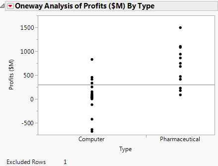

Select Rows > Exclude/Unexclude. The data point is no longer included in calculations.
Select Rows > Hide/Unhide. The data point is hidden from all graphs.
To re-create the plot without the outlier, select Redo > Redo Analysis from the red triangle menu for Oneway Analysis. You can close the original Scatterplot window.
Figure 3.93 Updated Plot

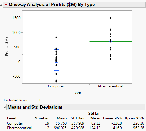

Display Options > Mean Lines. This adds mean lines to the scatterplot.
Means and Std Dev. This displays a report that provides averages and standard deviations.
Figure 3.94 Mean Lines and Report

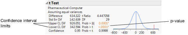

To perform the t-test, select Means/Anova/Pooled t from the red triangle for Oneway Analysis.
Figure 3.95 t Test Results
Use the confidence interval limits to determine how much difference exists in the profits of both types of companies. Look at the Upper CL Dif and Lower CL Dif values in Figure 3.95. The financial analyst concludes that the average profit of pharmaceutical companies is between $343 million and $926 million higher than the average profit of computer companies.
