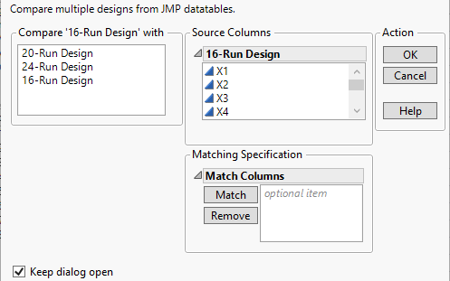

Launch the Compare Designs platform by selecting DOE > Design Diagnostics > Compare Designs. All open data tables appear in the list at the left. The active data table and its columns appear in a Source Columns panel. The design in the initial Source Columns panel is the reference design, namely, the design to which other designs are compared. When you add designs to compare to the reference design, their columns appear in panels under the reference design panel.
Figure 15.17 shows the launch window for the three designs in Designs of Different Run Sizes.
Figure 15.17 Compare Designs Launch Window

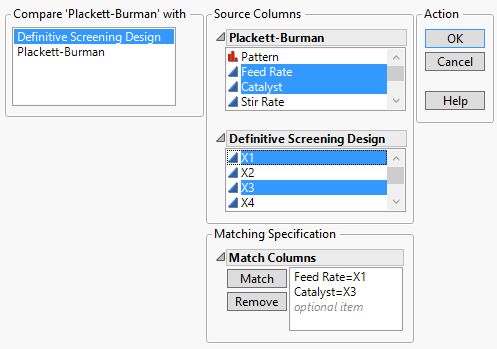

Figure 15.18 Selection of Columns for Matching
To match several columns that appear in the correct matching order in each list, select them in each list. Click the Match button. They are matched in their list order. See Figure 15.18. In this example, Feed Rate is matched with X1, and Catalyst is matched with X3.
