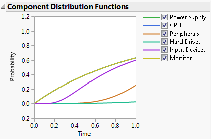

Component Plots
Select Show Component Distribution Functions to show an overlay plot of the distribution functions for the components of the Reliability Block Diagram.
Figure 10.24 Component Distribution Functions

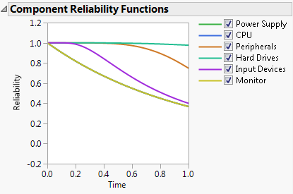

Select Show Component Reliability Functions to show an overlay plot of the reliability functions for the components of the Reliability Block Diagram.
Figure 10.25 Component Reliability Functions

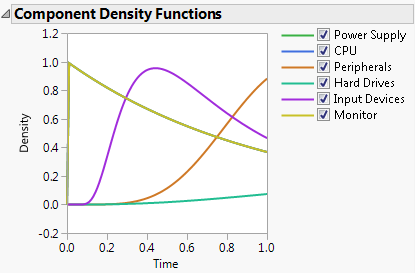

Select Show Component Density Functions to show an overlay plot of the density functions for the components of the Reliability Block Diagram.
Figure 10.26 Component Density Functions

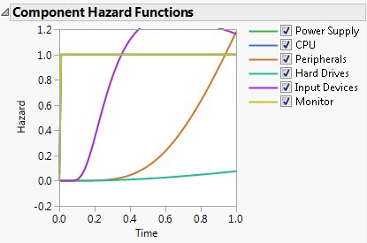

Select Show Component Hazard Functions to show an overlay plot of the hazard functions for the components of the Reliability Block Diagram.
Figure 10.27 Component Hazard Functions

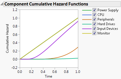

Select Show Component Cumulative Hazard Functions to show an overlay plot of the cumulative hazard functions for the components of the Reliability Block Diagram.
Figure 10.28 Component Cumulative Hazard Functions
