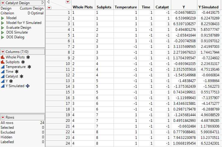

Click Make Design.
13.
Click Make Table.
Note: The entries in your Y and Y Simulated columns will differ from those that appear in Figure 9.106.
Figure 9.106 Design Table
Figure 9.107 Simulate Responses Window

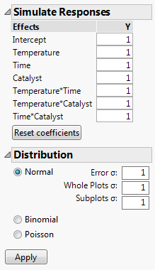

The design table and a Simulate Responses window appear. Notice that the design table contains a DOE Simulate script. At any time, you can run this script to specify different parameter values.
Click Apply.
In the data table, the formula for Y Simulated updates to reflect your specifications. To view the formula, click on the plus sign to the right of the column name in the Columns panel.

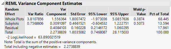

Click Run.
Note: Because the values in Y Simulated are randomly generated, the entries in your report will differ from those that appear in Figure 9.108.
Figure 9.108 REML Report Showing Wald Confidence Intervals

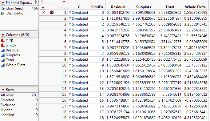

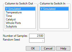

In the REML Variance Components Estimates outline, right-click in the Var Component column and select Simulate.
Figure 9.109 Simulate Window
In your simulations, you replace the column Y Simulated, which you used to run your model, with a new instance of the column Y Simulated, which generates a new column of simulated values for each simulation. The column on which you right-clicked and that appears as selected, Var Component, will be simulated for each effect listed in the Parameter Estimates table.
(Optional) Next to Random Seed, enter 456.
This reproduces the values shown in Figure 9.110, except for the values in row 1.
Click OK.
The first row of the Fit Least Squares Simulate Results (Var Component) data table contains the initial values of Var Component and is excluded. The remaining rows contain simulated values.

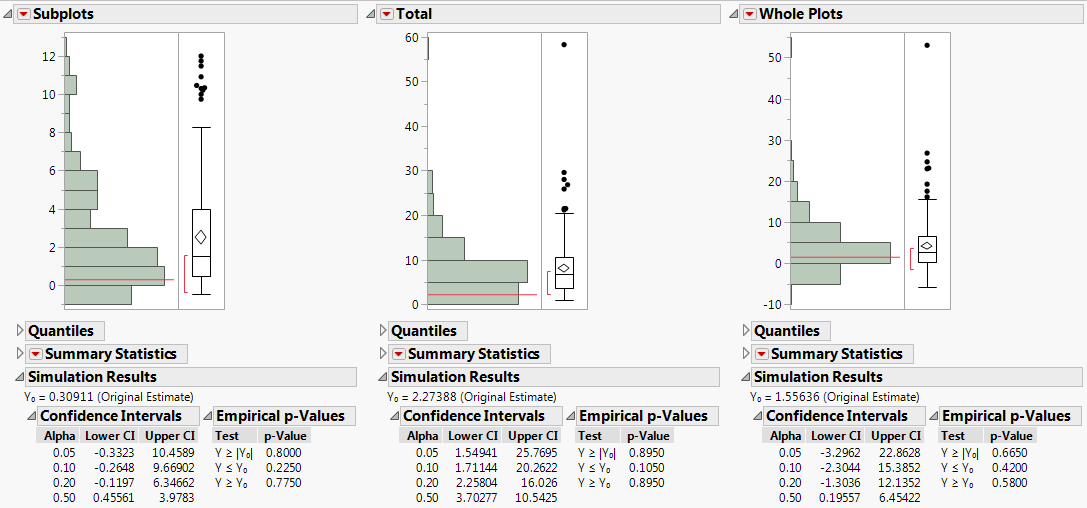

Run the Distribution script.
For each variance component, confidence intervals at various confidence levels are shown in the Simulation Results report (Figure 9.111). Compare the 95% intervals in the Alpha=0.05 row of each table to the intervals given in the REML report (Figure 9.108):
