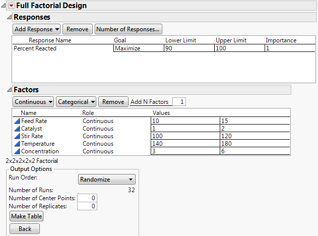

Select DOE > Classical > Full Factorial Design.
Click the Full Factorial Design red triangle and select Load Responses.
5.
Click the Full Factorial Design red triangle and select Load Factors.
6.
Click Continue.

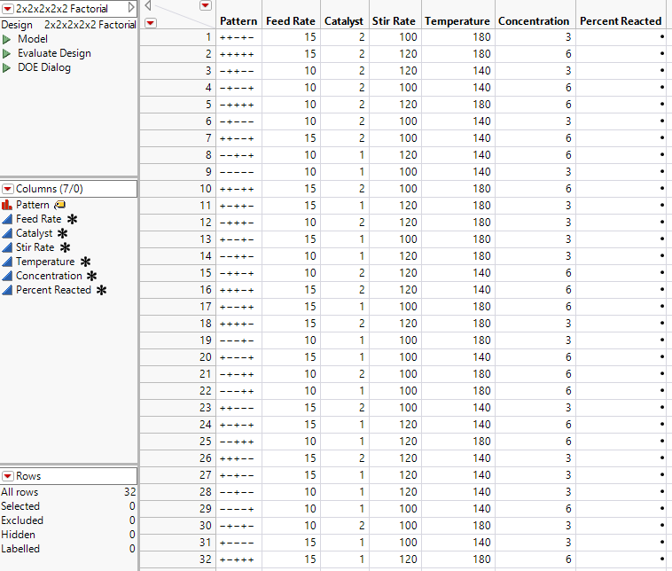

8.
Click Make Table.
The first column in the design data table shows the factor level combination for each run in terms of + and - signs, indicating high and low factor settings. The table also has an empty Y column named Percent Reacted for entering response values as you conduct the experiment.
Figure 11.3 Full Factorial Design for Reactor Experiment
