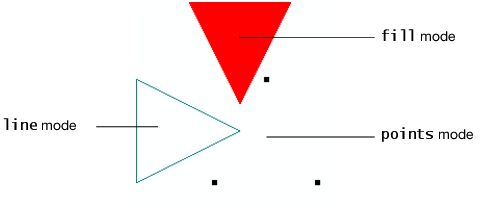

To set the drawing mode of a polygon, use the Polygon Mode command.
Polygon Mode (face, mode)
Figure 12.12 Points, Line, and Fill Modes
For example, the following script creates a display list that defines a triangle. This display list is used three times in conjunction with Translate, Rotate, and Color commands to draw triangles in three positions. In addition, the Polygon Mode command changes the drawing mode of each triangle. Note there is no explicit call to the FILL mode, since it is the default.
The following table dissects the script, showing how the Translate and Rotate commands accumulate to manipulate a single display list.
shape = Scene Display List(); |
shape << Begin(TRIANGLES); shape << Vertex(0, 0, 0); shape << Vertex(-1, 2, 0); shape << Vertex(1, 2, 0); shape << End(); |
Creates a display list named shape that holds vertices for the triangles. All the z vertices are zero since this is a two dimensional scene
scene = Scene Box( 200, 200 ); New Window( "Fill Modes", scene ); scene << Ortho2d(-2,2,-2,2); |
scene << Color(1,0,0); scene << Call List(shape); scene << Update; // update the scene to see the triangle
scene << Rotate (90, 0, 0, 1); scene << Translate (-0.5, 0, 0); scene << Color(0, 0.5, 0.5); scene << Polygon Mode(FRONT_AND_BACK, LINE); scene << Call List(shape); scene << Update; // update the scene to see the triangle
scene << Rotate(90, 0, 0, 1); scene << Translate(-0.5, -1, 0); scene << Color(0, 0, 0); scene << Point Size(5); // large points so they are visible scene << Polygon Mode(FRONT_AND_BACK, POINT); scene << Call List(shape); scene << Update; // update the scene to see the triangle
