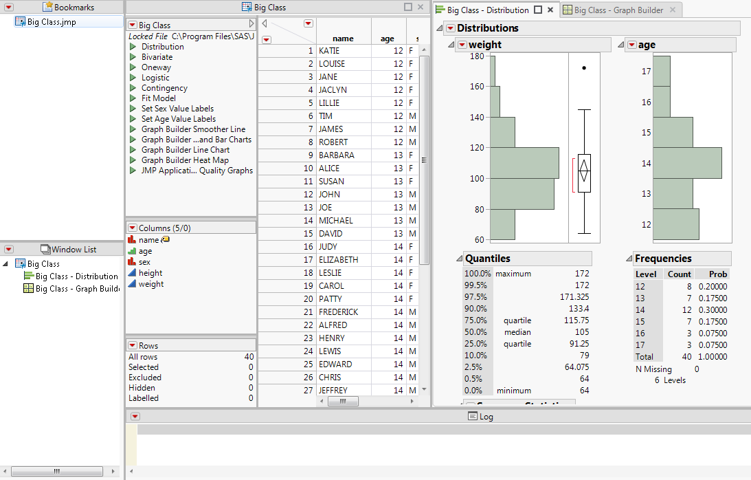

Set Layout specifies the layout of the tabs that show the data table and output.
project << Set Layout(
H Splitter Box(
<<Set Sizes( {0.15, 0.85} ),
V Splitter Box(
Size( 182, 700 ),
<<Set Sizes( {0.5, 0.5} ),
Tab Page Box( // show the Bookmarks pane
Window ID( "Bookmarks" )
Tab Page Box( // show the Windows pane
Window ID( "Windows" )
V Splitter Box(
<<Set Sizes( {0.85, 0.15} ),
H Splitter Box(
<<Set Sizes( {0.43, 0.57} ),
Tab Page Box( // show the data table
Window ID( "data" )
Tab Box(
Tab Page Box( // show the Distribution graph and reports
Window ID( "distrib" )
Tab Page Box( // show the Graph Builder graph
Window ID( "graphbuilder" )
Tab Page Box(
Window ID( "Log" ) )

Figure 14.2 Example of a Complex Project
project = Open( "Big Class.jmpprj" );
