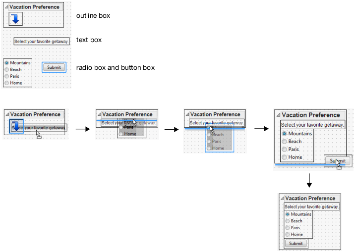

The top and left edges of an object align (or snap) to the nearest dotted grid lines as you drag them on the workspace. For a more precise placement, deselect Snap to Grid in the Application Builder red triangle menu. You can also turn off Snap to Grid for all applications in the JMP Preferences. Select File (Windows) or JMP (Macintosh)> Preferences > Platforms > JMP App to change the option.
Figure 15.5 shows the various methods for dragging objects inside a container.
Figure 15.5 Examples of Dragging Objects into a Container
To position a container object precisely, select the object and then change the X Position and Y Position properties. After you enter a new X position, press the TAB key to see the object move to the new position and then enter the new Y position.
To place an object in the upper left corner, right-click the object and select Move to Corner. This is a shortcut to setting the X and Y positions to 0. On Macintosh, hold down CTRL and COMMAND and then select Move to Corner.
To line up objects horizontally or vertically, select the objects and then select an option from the Format > Align Boxes menu.
The Align Boxes options are unavailable when you select a container rather than the internal objects.
After inserting some containers, you can change them to a different type of container without having to re-create the object. Suppose that you create a panel that contains text and a button. To see what the panel looks like as an outline, select the panel, right-click in the module, and then select Change Container > Outline Box (Figure 15.6).
Figure 15.6 Change a Panel to an Outline
Tip: To change the orientation of a list box quickly, select or deselect Horizontal in the object properties.

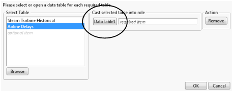

Specifies the absolute or relative filepath for the data table used in the application. You can precede the data table name with a path variable (such as $HOME or $USER_APPDATA).
Specifies the string used when prompting the user to open a data table. Figure 15.9 shows the default value.
Figure 15.9 Label in Data Table Prompt Window

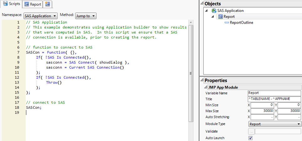

To see the scripts in these namespaces, click the Scripts tab and then select the namespace in the Namespace list (or in the Objects pane). See Figure 15.10.
Figure 15.10 Application and Module Namespaces
