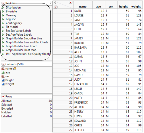

To automatically complete various analyses and tasks, you can create a JSL script and save it to the data table. See Figure 3.50. For details about writing data table scripts, see Table Scripts in the Scripting Guide.
Figure 3.50 Scripts Saved With the Data Table
From the report window, click on the red triangle menu for the platform and select Save Script > To Data Table.

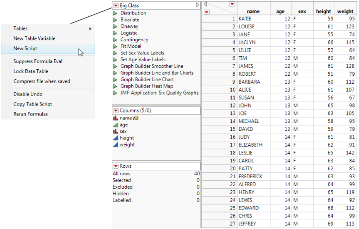

Figure 3.51 Creating a Script
Select New Script.
If you are finished editing the script, click OK. The script appears in the Table panel and the window closes.
If you are not finished editing the script and want to save it, click Save. The script appears in the Table panel and the window remains open for further editing.
