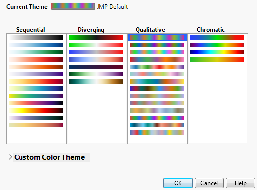

Figure 3.29 Continuous Color Themes Window
Figure 3.30 Categorical Color Themes Window

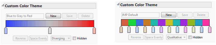

Figure 3.31 shows the color theme panels for both continuous and categorical themes (respectively).
Figure 3.31 Custom Color Theme Panel

Click New to create a new theme.
8.
Click Save to save the custom color theme.
9.
Click OK to close the color theme window.

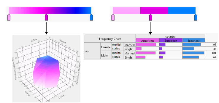

Figure 3.32 Examples of Continuous and Categorical Color Themes
