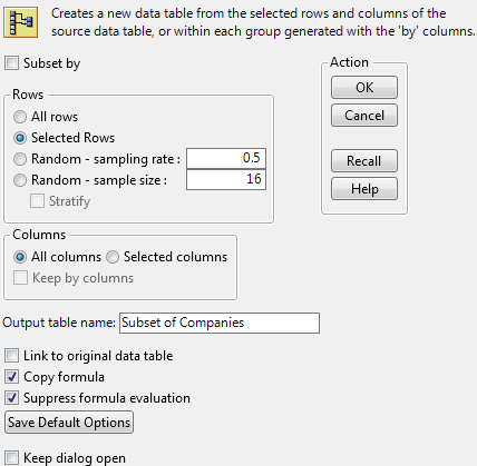

Select Tables > Subset to launch the Subset window.
Figure 1.36 Subset Window
8.
Select Selected columns to subset only the columns that you selected. You can also customize your subset table further by selecting additional options.
9.
Click OK.
The resulting subset data table has seven rows and three columns. For complete details about the Subset command, see Create a Subset Data Table in the Using JMP book.
