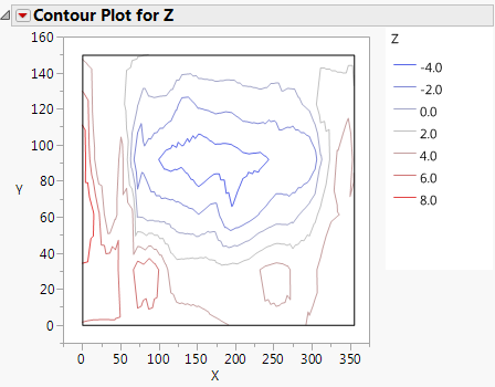

Figure 8.35 Contour Plot before Customization
Right-click on the plot and select Customize.
5.
Click Shape.
6.
Change the Line Width to 2.0.
7.
Click on the color next to Line Color and select a shade of green.
8.
Click OK.

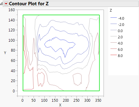

Figure 8.36 Customized Contour Plot

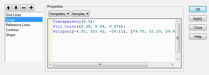

Figure 8.38 The Polygon Sample Script

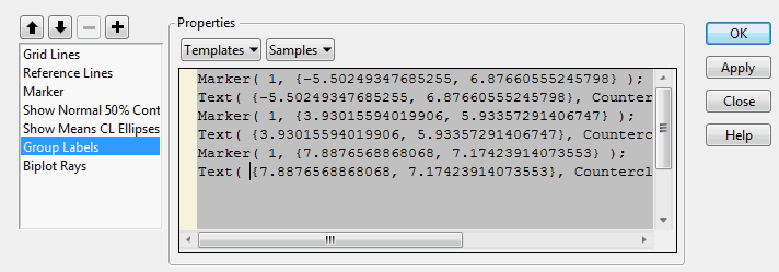

In some graphs, you can view the JSL that creates graphical elements. Figure 8.39 shows the Group Label script for a Discriminant Analysis graph. The script defines markers and text for group labels. The commands included in these built-in scripts cannot be modified or deleted. You can insert commands from the Templates or Samples list, but you cannot click in the window and type new commands.
Figure 8.39 Example of JSL That Creates Group Labels

(Optional) Click Apply to update the graph with your changes without closing the window. Unlike other property changes, script changes to not take effect until you click Apply or OK.
