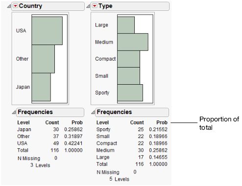

Select Analyze > Distribution.
3.
Select Country and Type and click Y, Columns.
4.
Figure 3.86 Distribution for Country and Type
The report window includes a bar chart and a Frequencies report for Country and Type. The bar chart is a graphical representation of the frequency information provided in the Frequencies report. The Frequencies report contains the following:

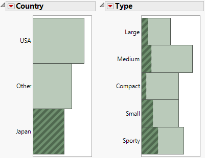

Figure 3.87 Japanese Cars

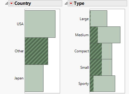

Figure 3.88 Other Cars
