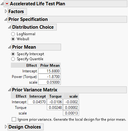

Under Prior Mean, enter the prior acceleration model parameter estimates that you obtained using the Fit Life by X platform with the hypothetical data. Round the values shown in the Estimates outline in Figure 21.3 to two decimal places:
Enter -1.87 for Power (Torque).
De-select the option Ignore prior variance. Generate the local design for the prior mean.
In the row and column for Intercept, click on 0.10000 and type 0.04570.
In the row for Intercept and column for Torque, click on 0.00000 and type -0.01062.
In the row for Intercept and column for scale, click on 0.00000 and type -0.00015.
In the row and column for Torque, click on 0.10000 and type 0.00248.
In the row for Torque and column for scale, click on 0.00000 and type 0.00002.
In the row and column for scale, click on 0.10000 and type 0.00013.
Figure 21.5 Completed Prior Specification Outline

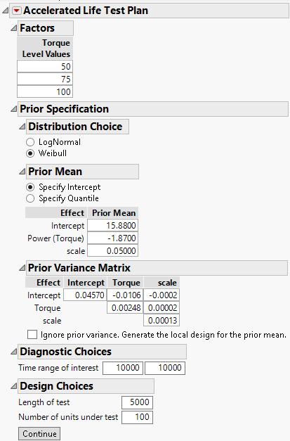

Click the Accelerated Life Test Plan red triangle and select ALT Optimality Criterion > Make Failure Probability Optimal.
6.
In the Design Choices outline. Enter 5,000 for Length of test and 100 for Number of units under test.
Figure 21.6 shows the completed Accelerated Life Test Plan outline.
