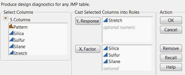

To launch the Evaluate Design platform, open the data table of interest and select DOE > Design Diagnostics > Evaluate Design. The example in Figure 14.10 uses the Bounce Data.jmp sample data table, located in the Design Experiment folder.
Figure 14.10 Evaluate Design Launch Window
