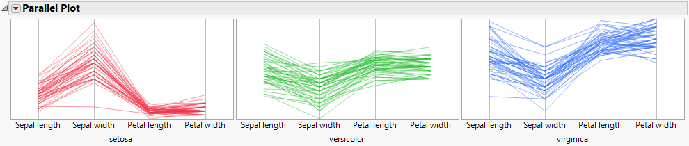

Figure 8.10 Three Species in One Parallel Plot
From Figure 8.10, you observe the following:
Click OK.
Figure 8.11 Three Species in Different Parallel Plots
