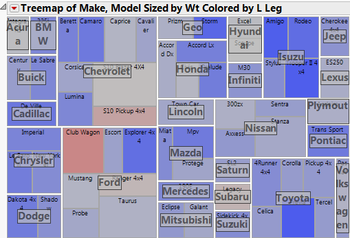

Select Graph > Legacy > Treemap.
L Leg represents a measurement of injuries resulting from the deceleration speed of the left leg, where more deceleration causes more injury.
5.
Click OK.
Figure 10.19 Left Leg Deceleration Injuries
From Figure 10.19, you can see that the Club Wagon and S10 Pickup 4x4 have the largest number of left leg deceleration injuries.

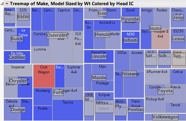

From the red triangle menu, select Change Color Column.
Select Head IC.
Click OK.
Figure 10.20 Head Injuries
From Figure 10.20, you notice the following:
