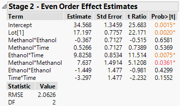

Figure 7.3 Stage 2 Report for Even-Order Effects
Because three main effects are identified as active in Stage 1, the guided subset selection procedure for active second-order effects can continue until all second-order effects are included. Because all six second-order effects are reported in Stage 2, it follows that the Stage 2 RMSE remained larger than the Stage 1 RMSE. See Stage 2 Methodology.

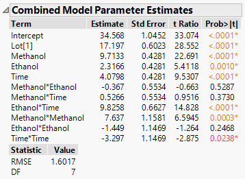

Figure 7.4 Combined Model Parameter Estimates Report
