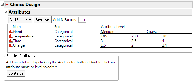

You can enter factors either manually or automatically using a preexisting table that contains the factors and settings. In this example, for convenience, you use a preexisting table. But, if you are designing a new experiment, you must first enter the factors manually. For details on entering factors manually, see Attributes.
Click the Choice Design red triangle and select Load Factors.
Figure 17.2 Choice Design Window with Attributes Defined
