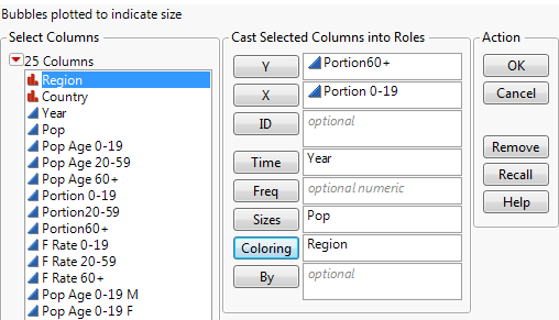

This example uses the PopAgeGroup.jmp sample data table, which contains population data for countries and regions around the world. Examine the relationship between the proportion of younger and older people in the sample populations.
Select Graph > Bubble Plot.
Figure 7.2 The Bubble Plot Launch Window

Bubbles for different regions are assigned different colors. See the Region legend in Figure 7.3. The colors shown in the plot are JMP default colors.
9.
Click OK.
