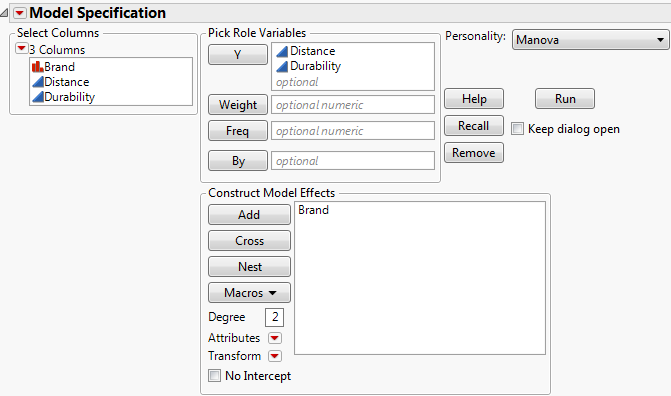

Select Analyze > Fit Model.
5.
Figure 8.1 Manova Setup

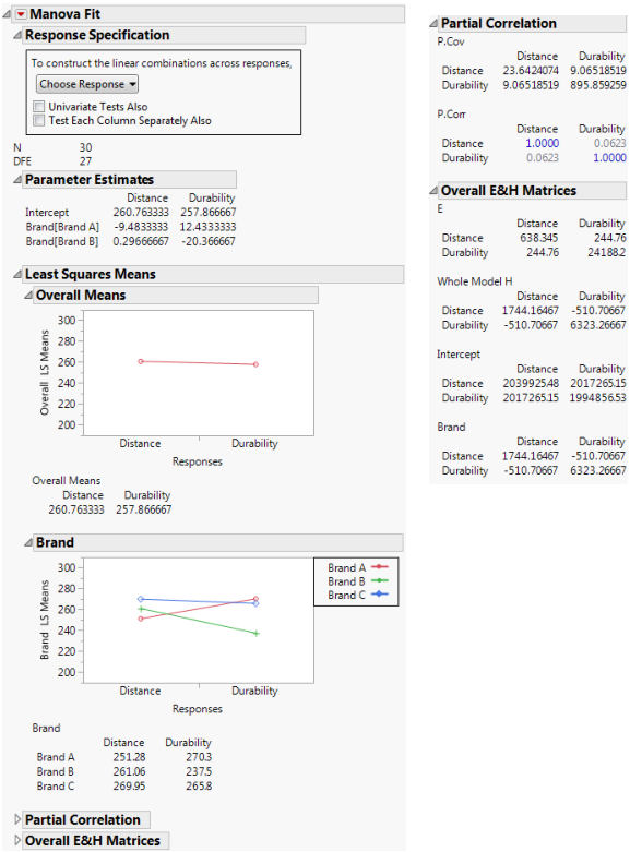

Click Run.
Figure 8.2 Manova Report Window
The initial results might not be very interesting in themselves, because no response design has been specified yet. After you specify a response design, the multivariate platform displays tables of multivariate estimates and tests. For details about specifying a response design, see Response Specification.
