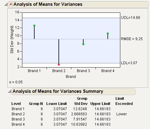

From the red triangle menu, select Analysis of Means Methods > ANOM for Variances.
Figure 6.14 Example of Analysis of Means for Variances Chart
From Figure 6.14, notice that the standard deviation for Brand 2 exceeds the lower decision limit. Therefore, Brand 2 has significantly lower variance than the other brands.
