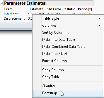

Right-click the Estimate column in the Parameter Estimates report and select Bootstrap (Figure 10.131).
Figure 10.131 The Bootstrap Option
The column that you right-click is relevant when the Split Selected Column option is selected. For more information, see Bootstrapping Window Options.
