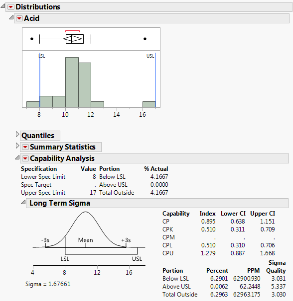

Select Analyze > Distribution.
Click OK.
5.
6.
Type 8 for the Lower Spec Limit.
7.
Type 17 for the Upper Spec Limit.
9.
Click the Acid red triangle and deselect Histogram Options > Vertical.
Figure 2.21 Example of the Capability Analysis Report
