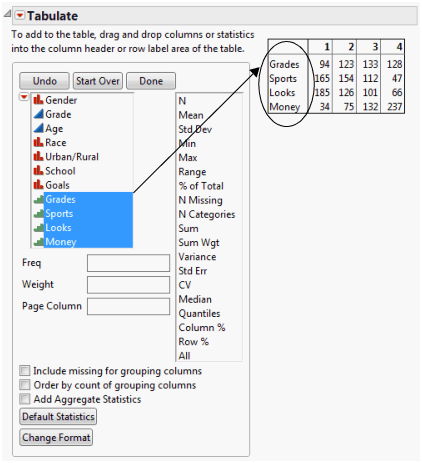

You have data from students indicating the importance of self-reported factors in children’s popularity (grades, sports, looks, money). Suppose that you want to see all of these factors in a single, combined table with additional statistics and factors. You want the table to look like Figure 8.99.
Figure 8.99 Adding Demographic Data
Select Analyze > Tabulate.
Figure 8.100 Columns by Categories

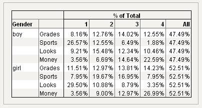

Drag Gender into the empty heading at left.
5.
Drag % of Total above the numbered headings.
6.
Drag All beside the number 4.
Figure 8.101 Gender, % of Total, and All Added to the Table

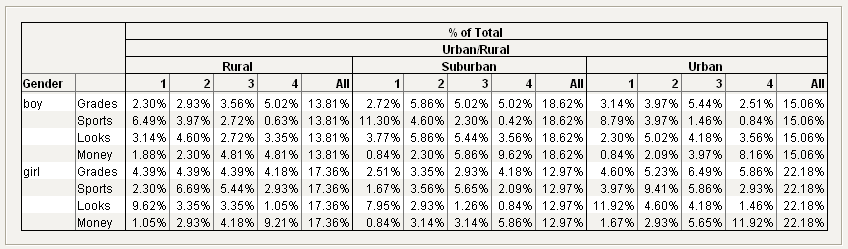

7.
Figure 8.102 Urban/Rural Added to the Table
