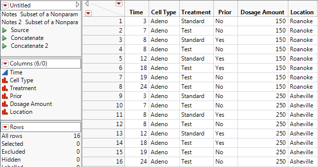

For example, suppose that two cancer trials were conducted at two different hospitals. One of the trials’ data is in the Cancer1.jmp data table, and the other trial’s data is in the Cancer2.jmp data table.
Notice that there are two distinct table variables: Dosage Amount and Location. In the concatenated table, columns are created for these two table variables.
Click OK.
Figure 5.21 Data and Variables Concatenated
