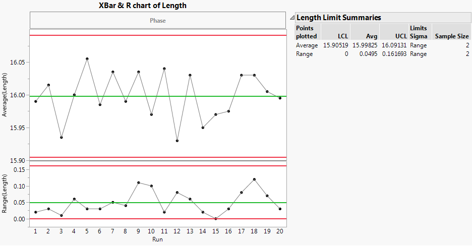

This example is in three parts. In most cases, you would start with Create the Baseline Control Chart, where you let JMP calculate the control limits for you. Then, to apply these control limits to new data, you would either Specify Control Limits or Specify Multiple Sets of Control Limits (for phase data).
Select Help > Sample Data Library and open Quality Control/Line Length.jmp.
Select Analyze > Quality and Process > Control Chart Builder.
Drag Length to the Y zone.
Drag Run to the Subgroup zone (at bottom).
Figure 2.8 XBar and R Chart of Line Length by Print Run
The XBar and R-charts have three lines drawn horizontally across them. These are the calculated LCL (lower control limit), Avg (average) and UCL (upper control limit).
5.
In the XBar-chart, right-click and select Warnings > Tests > All Tests.

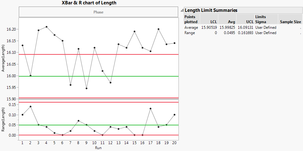

Select Help > Sample Data Library and open Quality Control/New Length Data.jmp.
5.
Right-click in the Average (XBar) chart and select Limits > Set Control Limits.
7.
8.
10.
Figure 2.9 XBar and R Chart of Line Length with Historical Limits

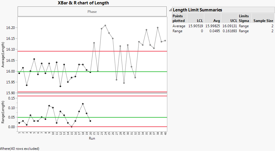

Select Help > Sample Data Library and open Quality Control/Combined.jmp.
Figure 2.10 XBar and R Chart of Line Length with Excluded Data

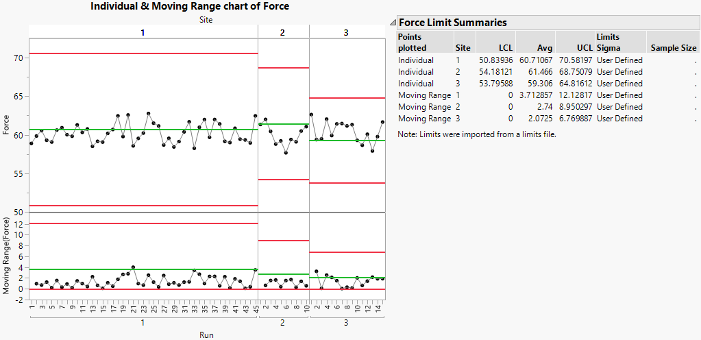

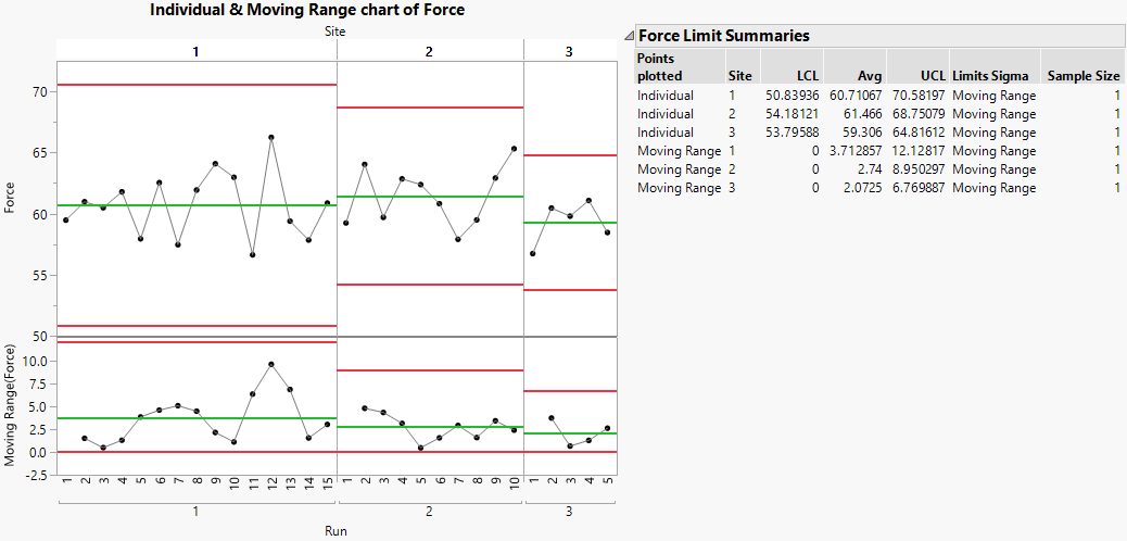

Select Help > Sample Data Library and open Quality Control/Phase Historical Data.jmp.
Drag Force to the Y zone.
5.
Drag Site to the Phase zone.
Figure 2.11 Baseline Control Chart for Existing Data
From the report in Figure 2.11, click the red triangle next to Control Chart Builder and select Save Limits > in New Table.
Select Help > Sample Data Library and open Quality Control/Phase New Data.jmp.
5.
6.
7.
8.
Click the red triangle next to Control Chart Builder and select Get Limits. Open the limits table you saved in step 2.
Figure 2.12 Control Chart for New Data Based on Historical Limits
