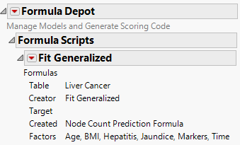

To save the Formula Depot, select File > Save.
Figure 10.2 Formula Depot with a Generalized Model
