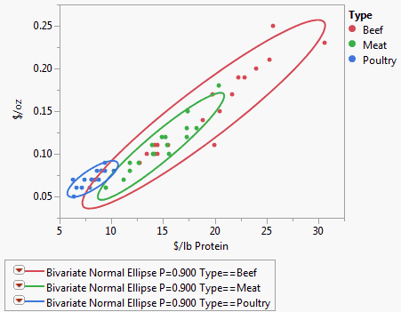

This example uses the Hot Dogs.jmp sample data table. The Type column identifies three different types of hot dogs: beef, meat, or poultry. You want to group the three types of hot dogs according to their cost variables.
Select Analyze > Fit Y by X.
5.
Click OK.
6.
From the red triangle menu, select Group By.
7.
From the list, select Type.
8.
Click OK.
If you look at the Group By option again, you see it has a check mark next to it.
9.
From the red triangle menu, select Density Ellipse > 0.90.
To color the points according to Type, proceed as follows:
10.
Right-click on the scatterplot and select Row Legend.
11.
Figure 4.46 Example of Group By
The ellipses in Figure 4.46 show clearly how the different types of hot dogs cluster with respect to the cost variables.
