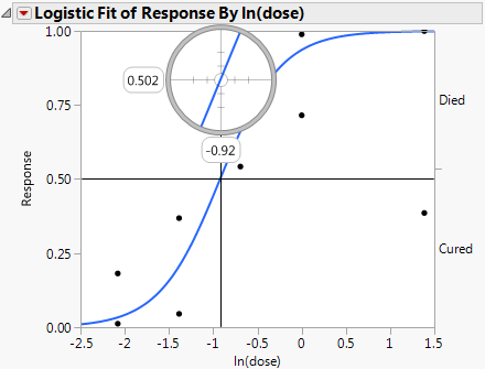

In a study of rabbits who were given penicillin, you want to know what dose of penicillin results in a 0.5 probability of curing a rabbit. In this case, the inverse prediction for 0.5 is called the ED50, the effective dose corresponding to a 50% survival rate. Use the crosshair tool to visually approximate an inverse prediction.
Select Analyze > Fit Y by X.
Notice that JMP automatically fills in Count for Freq. Count was previously assigned the role of Freq.
5.
Click OK.
7.
Place the horizontal crosshair line at about 0.5 on the vertical (Response) probability axis.
8.
Move the cross-hair intersection to the prediction line, and read the In(dose) value that shows on the horizontal axis.
In this example, a rabbit with a ln(dose)of approximately -0.9 is equally likely to be cured as it is to die.
Figure 7.78 Example of Crosshair Tool on Logistic Plot
