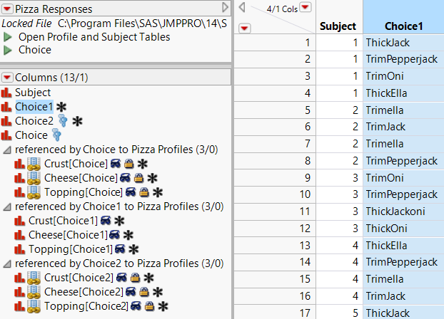

Figure 5.40 Selected Column in Virtually Joined Data Table

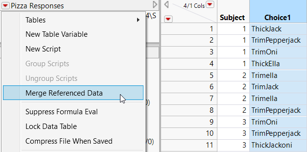

From the data table’s red triangle menu, select Merge Referenced Data.
Figure 5.41 Merging Referenced Data

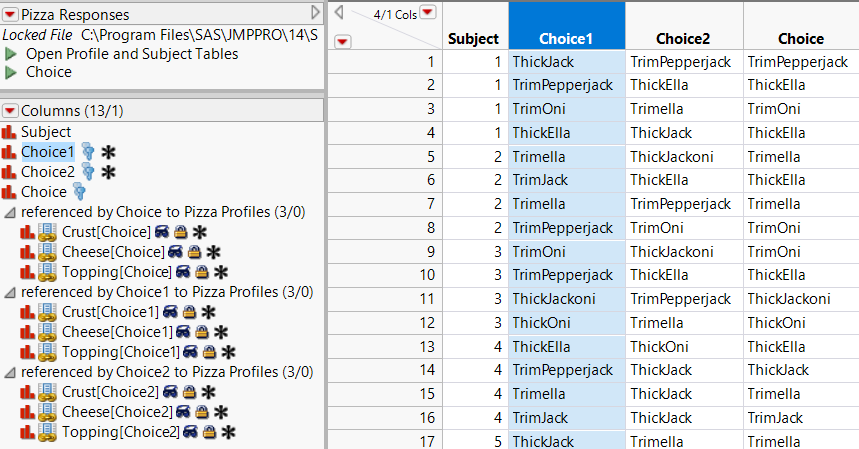

A message confirms that the selected column was merged. Notice that the virtual join icon for Choice1 no longer appears in the Column list. The Link Reference column property was removed.
Figure 5.42 Merged Data
