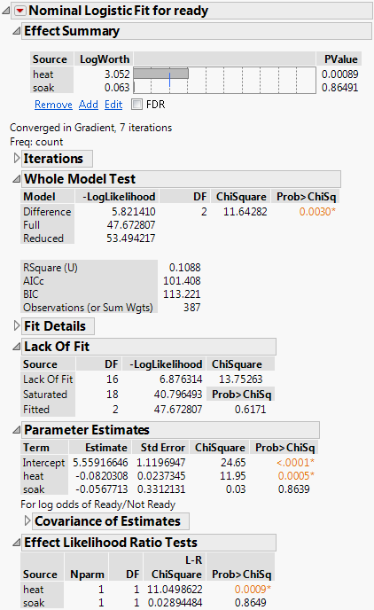

Click Run.
Figure 10.2 Nominal Logistic Fit Report
In the Whole Model Test report, the chi-square statistic (11.64) has a small p-value (0.0030), which indicates that the overall model is significant. However, the parameter estimate for soak has a p-value of 0.8639, which indicates that soaking time might not be important.

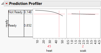

Figure 10.3 Prediction Profiler
