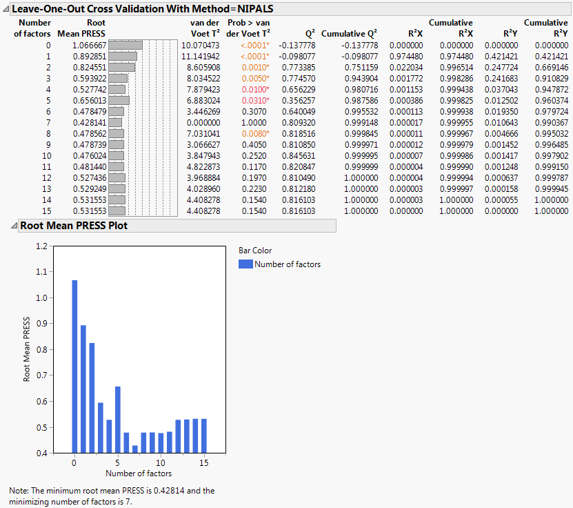

Select Leave-One-Out as the Validation Method.
7.
A portion of the report appears in Figure 5.2. Since the van der Voet test is a randomization test, your Prob > van der Voet T2 values can differ slightly from those in Figure 5.2.
Figure 5.2 Partial Least Squares Report
The van der Voet T2 statistic tests to determine whether a model with a different number of factors differs significantly from the model with the minimum PRESS value. A common practice is to extract the smallest number of factors for which the van der Voet significance level exceeds 0.10 (SAS Institute Inc 2017d; Tobias 1995). If you were to apply this thinking here, you would fit a new model by entering 6 as the Number of Factors in the Model Launch panel.

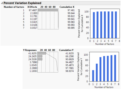

Figure 5.3 Seven Extracted Factors

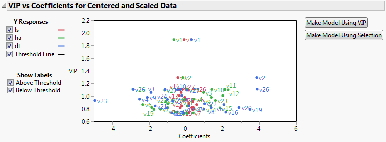

Select VIP vs Coefficients Plot from the NIPALS Fit with 7 Factors red triangle menu.
Figure 5.5 VIP vs Coefficients Plot
