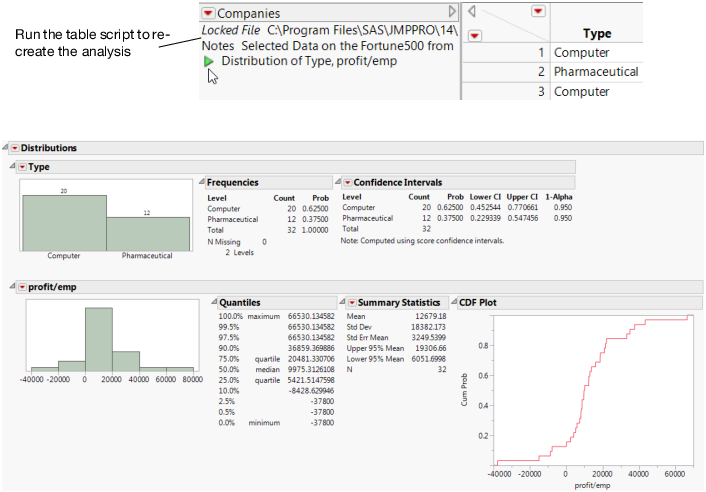

Select Help > Sample Data Library and open Companies.jmp.
Select Analyze > Distribution.
Select Type and profit/emp and click Y, Columns.
Histogram Options > Show Counts
Outlier Box Plot, to remove the outlier box plot

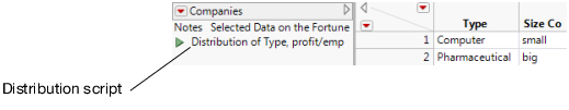

To save this analysis, select Save Script > To Data Table from the red triangle menu for Distributions. The new script appears in the Table panel.
Figure 5.137 Distribution Script
Figure 5.138 Running the Distribution Script
